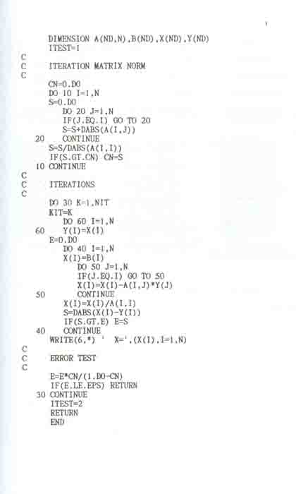

snot Δημοσ. 19 Δεκεμβρίου 2005 Δημοσ. 19 Δεκεμβρίου 2005 an den vlepeis tpt apo tis jpeg dwse mou mail na tis steilw se kalh poiothta
snot Δημοσ. 19 Δεκεμβρίου 2005 Δημοσ. 19 Δεκεμβρίου 2005 to vrika kai se psifiaki morfh C PROGRAM JACOB C C JACOBI'S METHOD C PARAMETER(ND=10) DOUBLE PRECISION EPS,A,B,X,Y,E DIMENSION A(ND,ND),B(ND),X(ND),Y(ND) READ(5,*) N,NIT,EPS READ(5,*) ((A(I,J),J=1,N),I=1,N) READ(5,*) (B(I),I=1,N) READ(5,*) (X(I),I=1,N) WRITE(6,*) 'INPUT:' WRITE(6,*) 'N=',N,' NIT=',NIT,' EPS=',EPS WRITE(6,*) 'A=' DO 10 I=1,N WRITE(6,*) (A(I,J),J=1,N) 10 WRITE(6,*) ' ' WRITE(6,*) 'B=',(B(I),I=1,N) WRITE(6,*) 'X=',(X(I),I=1,N) WRITE(6,*) ' ' WRITE(6,*) 'OUTPUT:' CALL JACOBI(ND,N,A,B,NIT,EPS,X,KIT,E,ITEST,Y) WRITE(6,*) 'ITEST=',ITEST,' KIT=',KIT WRITE(6,*) 'X=',(X(I),I=1,N) WRITE(6,*) 'E=',E STOP END C----------------------------------------------------------------- SUBROUTINE JACOBI(ND,N,A,B,NIT,EPS,X,KIT,E,ITEST,Y) C C SOLUTION OF THE LINEAR SYSTEM AX=B BY JACOBI'S METHOD C C INPUT: C ND: MAXIMUM COLUMN DIMENSION OF ARRAYS C N: DIMENSION OF ARRAYS C A: SYSTEM MATRIX (NXN) C B: RIGHT-HAND SIDE VECTOR (N) C NIT: MAXIMUM NUMBER OF ITERATIONS C EPS: CONVERGENCE TEST NUMBER C C OUTPUT: C X: APPROXIMATE SOLUTION VECTOR (N) C KIT: NUMBER OF EXECUTED ITERATIONS C E: ERROR BOUND C ITEST = 1, CONVERGENCE TEST SATISFIED C = 2, CONVERGENCE TEST NOT SATISFIED C DOUBLE PRECISION EPS,A,B,X,Y,CN,S,E DIMENSION A(ND,N),B(ND),X(ND),Y(ND) ITEST=1 C C ITERATION MATRIX NORM C CN=0.D0 DO 10 I=1,N S=0.D0 DO 20 J=1,N IF(J.EQ.I) GO TO 20 S=S+DABS(A(I,J)) 20 CONTINUE S=S/DABS(A(I,I)) IF(S.GT.CN) CN=S 10 CONTINUE C C ITERATIONS C DO 30 K=1,NIT KIT=K DO 60 I=1,N 60 Y(I)=X(I) E=0.D0 DO 40 I=1,N X(I)=B(I) DO 50 J=1,N IF(J.EQ.I) GO TO 50 X(I)=X(I)-A(I,J)*Y(J) 50 CONTINUE X(I)=X(I)/A(I,I) S=DABS(X(I)-Y(I)) IF(S.GT.E) E=S 40 CONTINUE WRITE(6,*) ' X=',(X(I),I=1,N) C C ERROR TEST C E=E*CN/(1.D0-CN) IF(E.LE.EPS) RETURN 30 CONTINUE ITEST=2 RETURN END
