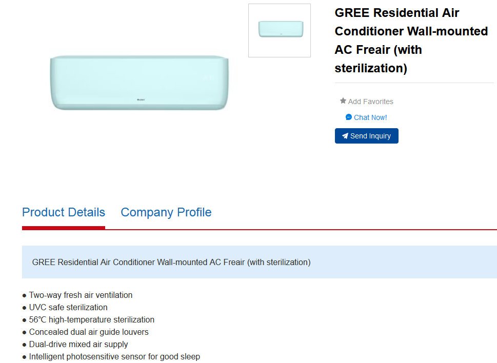

Mηπως ειναι ετοιμο το Ururu Sarara των φτωχων,απο την Gree? 1200e σε 12000btu(λιγο ακριβοτερο απο τα κορυφαια,περιπου 10%) στην Σερβια https://www.frigocool.rs/shop/gree/gree-klima-freair-premium-12k-inverter-sa-ugradnjom/ με ονομα Freair απο οπου αλιευσα σε μεταφραση αυτα:
Gree air conditioner FREAIR Premium Inverter Wi-Fi R32 of 12000 btu with installation which includes the basic obligatory 3m pipe installation. In case of the need for a longer pipe installation, each long meter is charged according to the valid price list of 1,500 dinars per long meter. The stated price is valid if you order the device with installation. Installation and free delivery is for Belgrade and the surrounding area. To purchase a device without installation, contact us.
The latest model for 2021
Manufacturer: Gree
Model: Freair Premium
Freair Premium inverter is the world's first air conditioner equipped with a precise sensor for measuring the concentration of CO2 indoors, in real time. After the CO2 detector detects an increased concentration of CO2 in the air, the leaf mark on the display changes color to yellow or red, depending on the air quality. The user can start the mode of injecting fresh air into the room, after reaching the required quality, the leaf on the display will be green again.
This provides insight into the air quality in the room.
Model: Wall
Inverter: Yes The latest technology G10 Inverter air conditioner
Freon: R32 New eco gas
Color: White
Air conditioning power: 12000 Btu
Integrated Wi-Fi: Yes
Cooling capacity: from 150 to 5000 (3700) W
Heating capacity: from 150 to 5000 (4800) W
Cooling input power: 75 to 1700 (822) W
Heating input power: from 90 to 1989 (822) W
Cooling current: 3.7 A
Heating current: 5.3 A
Temperature range for cooling operation: from 18 ° C to +43 ° C
Temperature range of work on breeding: from -15 ° C to +24 ° C
Heating capacity at -7 ° 😄 4320 W
Heating capacity at -15 ° 😄 3600 W
Cooling energy efficiency: A +
Heating energy efficiency: A + (middle zone), A ++ (warm zone)
SEER: 6.02
SCOP: 4.10 (middle zone), 4.60 (warm zone)
Power supply on the outdoor unit: 1Ph, 220-240V, 50Hz
Power cord type: 3 x 1.5 mm2
Interconnect cable: 4 x 1.5 mm2
Air flow: 650 m3 / h
Indoor unit noise level: 23/24/28/31/36/38/42 dB
Indoor unit dimensions (S x H x D): 960 x 305 x 200 mm
Indoor unit packaging dimensions (S x H x D): 1043 x 390 x 450 mm
Indoor unit weight: 14.5 kg
Indoor unit packing weight: 21 kg
Outdoor unit noise level: 52 dB
Minimum length of pipe installation: 3 m
Maximum length of pipe installation: 15 m
Maximum height length of pipe installation: 10 m
Outdoor unit dimensions (S x H x D): 850 x 575 x 350 mm
Outdoor unit packaging dimensions (S x H x D): 926 x 407 x 620 mm
Outdoor unit weight: 32 kg
Outdoor unit weight: 37 kg
Insight into the concentration of CO2 in the room
Highly efficient HEPA + fresh air filters
Intelligent unique air detection technologies provide insight into room air quality
Self-diagnosis
Turbo function
Auto-restart
Timer
Compact design
Memory function
Intelligent preheating
Intelligent defrost
Cold plasma fillers
Self-cleaning function
Three night modes
Heating to -15 ° C
Cooling to +43 ° C
7 fan speed
High energy efficiency
Quiet mode of operation
CO2 Detector
Fresh Air
Dirty filter alarm
High and low voltage protection
