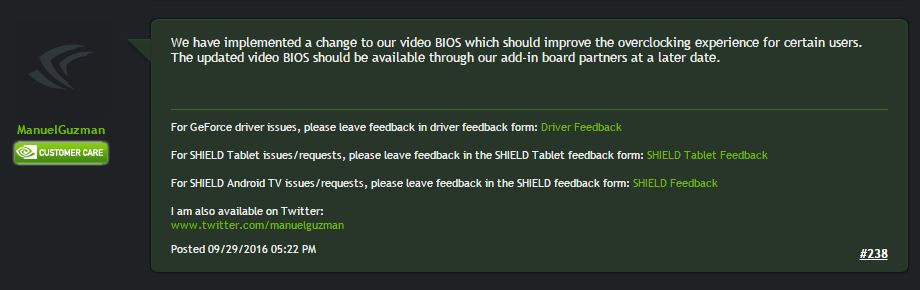

Δε μπορώ να βρω αυτό με τις αστάθειες, νομίζω είναι το παρακάτω.
 That is not entirely correct based on many data points we have seen reported, the customer experience is the final answer to determine if a product is problematic or not, during the first two months after release, when all GTX 1070s were using Samsung, you don't see a single report or complaint about memory, artifacting, quality or stability issues, after the switch to Micron you can't find a single computer forum without at least one complaint about memory, stability or quality issues, that must mean something.
It could very much be an incomplete BIOS implementation for the Micron memory controller that is responsible for most issues, but OC aside, from my experience and the two Micron samples i tested, they feel laggy in 2K & 4K than their Samsung counterparts even at stock setting, i did not measure frame time latency, but there seems to be something off about the latency or timings of these ICs, also with my current Micron sample, i was getting occasional artifacts in rotTR with driver 372.70 , after updating to 372.90 the artifacts disappeared at stock settings.
It was never the case with the two Samsung samples that i tried for about a month that i ever got any kind of issue whatsoever either on stock settings or when OCed to +600 or more, that also must mean something.
Micron GDDR5 running at 8 Gb/s is not out right defective, but it is sensitive and unstable, which lowers the overall product perceived quality and reliability, maybe this is the best way to explain the problem universally, and i keep wondering why they made the switch? NVIDIA did not give us an answer to that yet, and it looks like they don't want to give that information out no matter what.

Εχει κάποιες αστάθειες ο controller στις micron μνήμες σε σχέση με το ρεύμα που δίνει. Σε κάποιους εμφανίζεται σε stock καταστάσεις αλλά στους περισσότερους με oc.
Δεν έχεις να φοβάσαι κάτι από τη στιγμή που ανακοίνωσε vbios fix η nvidia
Περισσότερα εδώ
https://forums.geforce.com/default/topic/963768/geforce-drivers/gtx-1070-memory-vrm-driver-or-bios-bug-in-micron-memory-1070-cards-/16/
