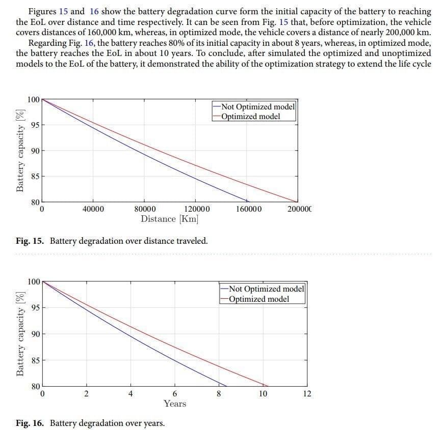

Red_Bear Δημοσ. 22 Σεπτεμβρίου Δημοσ. 22 Σεπτεμβρίου (επεξεργασμένο) 8 ώρες πριν, newlynx είπε Θα ήθελα τα νούμερα που παρέθεσαν να έχουν και χρονική παράμετρο, ώστε να δούμε και αυτό το σκέλος. 6 ώρες πριν, teodor_ch είπε Το έγραψα εξάλλου ότι δεν βλέπουμε την επίπτωση του χρόνου στην υγεία της μπαταρίας. Για να κάνω τα πράγματα λιγο πιο απλά παραθέτω την απάντηση της ΤΝ Gemini στο ερώτημα μου "how a EV battery degrades with time ? " Ιδου η απάντηση (οι υπογραμμίσεις δικές μου): EV batteries, like all lithium-ion batteries, experience a natural process of degradation over time, known as "calendar aging," regardless of how much you drive the vehicle. This is distinct from degradation caused by charging and discharging cycles (known as "cyclic aging"). Here's how calendar aging works and the factors that influence it: The Underlying Chemistry Calendar aging is a result of irreversible chemical reactions that occur within the battery cells even when they are not in use. The main mechanisms include: Solid Electrolyte Interphase (SEI) growth: The SEI is a protective layer that forms on the anode (negative electrode) during the first few charging cycles. Over time, and particularly at high temperatures and states of charge (SoC), this layer can continue to grow. This process consumes lithium ions that would otherwise be available for storing and releasing energy, leading to a permanent loss of capacity. Lithium plating: If the battery is charged in cold temperatures, lithium ions may not be able to insert themselves into the anode's graphite structure quickly enough. Instead, they can deposit as a metallic lithium layer on the surface of the anode, which is a significant and irreversible form of degradation. Electrolyte decomposition: The electrolyte, which allows lithium ions to move between the electrodes, can break down over time, leading to the formation of unwanted compounds that hinder battery performance. Key Factors that Accelerate Calendar Aging While calendar aging is an inherent process, its rate can be significantly influenced by several factors, even if the car is just sitting in the garage: Temperature: This is arguably the most significant factor. High temperatures accelerate the chemical reactions that cause degradation, especially the growth of the SEI layer. Conversely, extremely low temperatures can also be harmful, particularly during charging, as they can lead to lithium plating. Modern EVs have sophisticated thermal management systems (heating and cooling) to keep the battery in an optimal temperature range (typically 25-30°C or 77-86°F) to mitigate these effects. State of Charge (SoC): Storing a battery at a very high or very low state of charge for extended periods is detrimental. The battery's internal chemistry is more stressed at the extremes. High SoC (100%): Keeping the battery at 100% charge for a long time puts the most stress on the cells and is a primary accelerator of calendar aging. This is why many EV manufacturers and experts recommend charging only to 80% for daily use and only to 100% just before a long trip. Low SoC (near 0%): Leaving a battery completely discharged for a long time can cause damage and even render it unusable. Time: The longer a battery exists, the more calendar aging it will experience. This is why the "age" of an EV battery is a crucial metric, separate from its mileage. The Impact on EV Batteries While calendar aging is a reality, modern EV batteries are engineered to minimize its effects. Data from real-world EV usage shows that the average degradation rate is relatively slow, often around 1-2% per year. The highest rate of degradation typically occurs early in the battery's life, and then the rate slows down over time. This means that even if you don't drive your EV much, its battery capacity will still gradually decrease. However, for most users, this loss is slow enough that the battery will likely outlast the rest of the vehicle. This is why many manufacturers offer long warranties (typically 8 years/100,000 miles) on their battery packs, guaranteeing a certain state of health (e.g., that the battery will retain at least 70% of its original capacity). . Παραθέτω και ενα διάγραμμα από ένα τεχνικό άρθρο Από εδω γίνεται αντιληπτό γιατί οι περισσότεροι κατασκευαστες δίνουν όριο εγγύησης μπαταρίας τα 8 χρόνια, έως τότε με το χειρότερο σενάριο η μπαταρια θα χάσει έως 20% , Και ΕΔΩ το τεχνικό αρθρο . Επεξ/σία 22 Σεπτεμβρίου από Red_Bear 1
