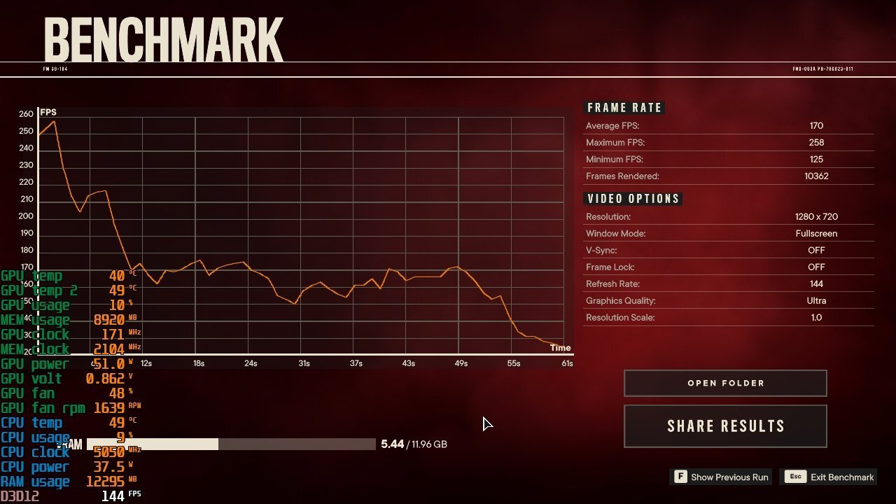

far cry 6
7800x3d + 6700xt/ 6000 cas 30
1440p ultra settings +FSR  Quality + dxr shadows/reflection enable
720p ultra settings +FSR  performance + dxr shadows/reflection enable
