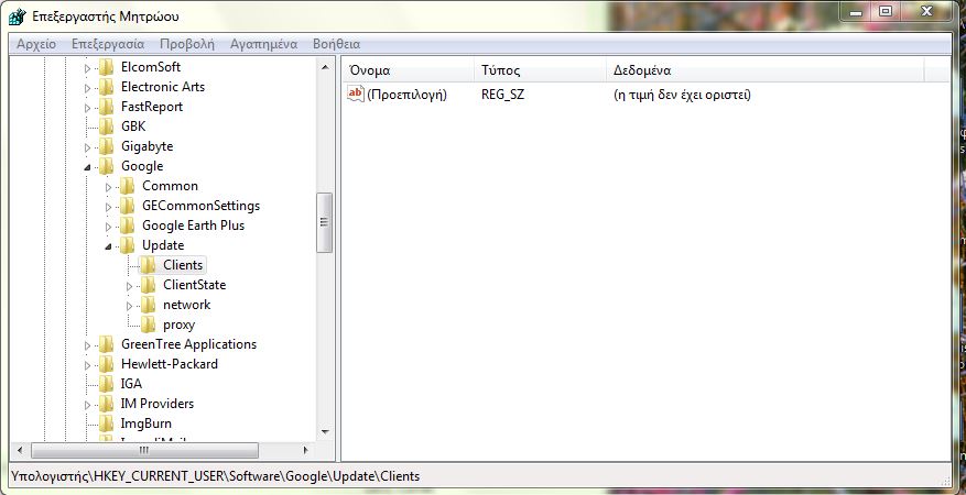

KilliK Δημοσ. 5 Δεκεμβρίου 2013 Δημοσ. 5 Δεκεμβρίου 2013 Στο 4 φτανω εδώ . Μετα που παω? Δεν βλεπω πουθενα το {430FD4D0-B729-4F61-AA34-91526481799D}? τοτε σβησε τελειως το update folder. και βαλε μετα τον Chrome. θα το ξαναφτιαξει απο την αρχη και θα βαλει τις τιμες που λειπουν.
Rod@X Δημοσ. 5 Δεκεμβρίου 2013 Δημοσ. 5 Δεκεμβρίου 2013 τοτε σβησε τελειως το update folder. και βαλε μετα τον Chrome. θα το ξαναφτιαξει απο την αρχη και θα βαλει τις τιμες που λειπουν. Το δοκιμασα 2 φορες χωρις απότελεσμα. 1) http://torrentz.eu/search?f=google+chrome <-- 2η επιλογή κατεβάζεις και δοκιμάζεις. 2) ATTENTION EVERYONE: The following method works when all others seem to fail: Temporarily disable your software firewall (eg. Norton Internet Security 2011, McAfee Internet Security, etc.). Since I use Norton Internet Security 2011, I simply right-click the tray icon, then click "Disable Snart Firewall" which brings up a dropdown to select how long I want to disable it. Hope this helps. 3) Error 3 is a failure to communicate with Google Update. Check if you're running Vista/ 7 and you have configured Google Chrome to always run as administrator.This is a known issue with the Google Chrome auto-updating mechanism and can be avoided by simply running Google Chrome as a normal user. Additionally, keep in mind that for security reasons we recommend that you don't elevate the privilege of Google Chrome to administrator.You can also try reinstalling Google Chrome and install through an alternate installer 4) Close Google Chrome Click the Start Orb In the search box, type CMD Click on the CMD icon and you will see the command window open Type: cd %localappdata%\google\update After you press enter, you cursor should now be in your google update directory Type: GoogleUpdate.exe /RegServer Running that only took a second. Open Google chrome and check ‘About Google Chrome’ again and it should now check the update servers successfully. If the above doesn’t work for you, have a look here: http://is.gd/x4cOPH Δοκίμασε τα κάτι θα κάνεις. Το τελευταίο μου φαίνεται πολλά υποσχόμενο. Κάποιο λάθος υπάρχει σαυτη την εντολή cd %localappdata%\google\update , "Το σύστημα δεν μπορεί να εντοπίσει την καθορισμένη διαδρομή του δίσκου"

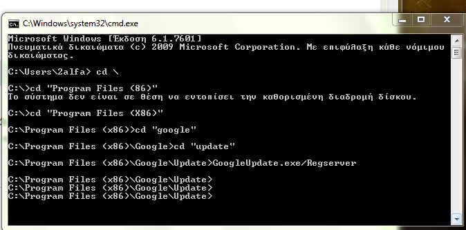

Avatar21 Δημοσ. 5 Δεκεμβρίου 2013 Δημοσ. 5 Δεκεμβρίου 2013 Πρώτων, το {430FD4D0-B729-4F61-AA34-91526481799D} το βρήκα σε μένα εδώ C:\Program Files (x86)\Google\Update Δεύτερων, ανοίγεις cmd πατάς με την σειρά: cd \ cd "Program Files" ( δες πρώτα που θα βρεις το google. Κάνε μία αναζήτηση στον c και ανάλογα πατάς η program files h program files 86 π.χ cd "google" cd "update" GoogleUpdate.exe/Regserver enter done. μετά κάνε αυτό και είσαι έτοιμος. Open Google chrome and check ‘About Google Chrome’ again and it should now check the update servers successfully. p.s Αυτά με την cmd τα έκανα μόνος μου και είμαι περήφανος
KilliK Δημοσ. 6 Δεκεμβρίου 2013 Δημοσ. 6 Δεκεμβρίου 2013 Το δοκιμασα 2 φορες χωρις απότελεσμα. oταν λεω update folder, εννοω το update key η οπως λεγεται, που βλεπεις στο registry, στη φωτο που μου εδειξες. σβηστο ολο αυτο.

Rod@X Δημοσ. 6 Δεκεμβρίου 2013 Δημοσ. 6 Δεκεμβρίου 2013 Πρώτων, το {430FD4D0-B729-4F61-AA34-91526481799D} το βρήκα σε μένα εδώ C:\Program Files (x86)\Google\Update Δεύτερων, ανοίγεις cmd πατάς με την σειρά: cd \ cd "Program Files" ( δες πρώτα που θα βρεις το google. Κάνε μία αναζήτηση στον c και ανάλογα πατάς η program files h program files 86 π.χ cd "google" cd "update" GoogleUpdate.exe/Regserver enter done. μετά κάνε αυτό και είσαι έτοιμος. Open Google chrome and check ‘About Google Chrome’ again and it should now check the update servers successfully. p.s Αυτά με την cmd τα έκανα μόνος μου και είμαι περήφανος Το κανα αλλα τα ιδια.
Avatar21 Δημοσ. 6 Δεκεμβρίου 2013 Δημοσ. 6 Δεκεμβρίου 2013 Tο enter δεν το γράφεις απλά το πατάς μετά .τέλος πάντως δοκίμασε να το κάνεις update τώρα. ---> (Open Google chrome and check ‘About Google Chrome’ again and it should now check the update servers successfully.)
Rod@X Δημοσ. 6 Δεκεμβρίου 2013 Δημοσ. 6 Δεκεμβρίου 2013 Tο enter δεν το γράφεις απλά το πατάς μετά .τέλος πάντως δοκίμασε να το κάνεις update τώρα. ---> (Open Google chrome and check ‘About Google Chrome’ again and it should now check the update servers successfully.) Ναι το παταω, Αυτη τη φορα δεν εβγαλε αμεσως το μηνυμα. Το εψαξε για λίγο και το εβγαλε σε 2-3 δευτερολεπτα. Και νομισα οτο κατι παει να γινει... αλλα δεν.
